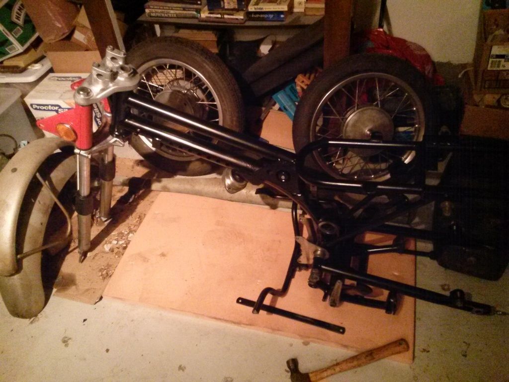

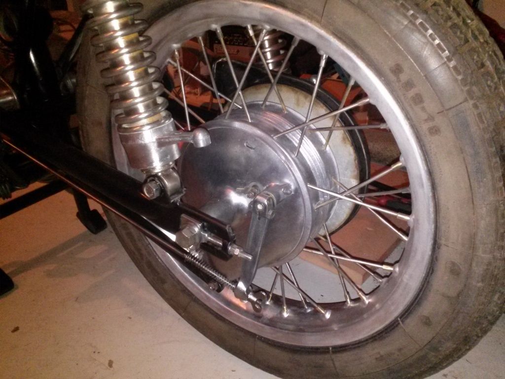

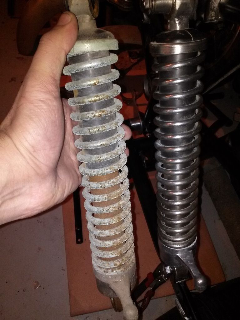

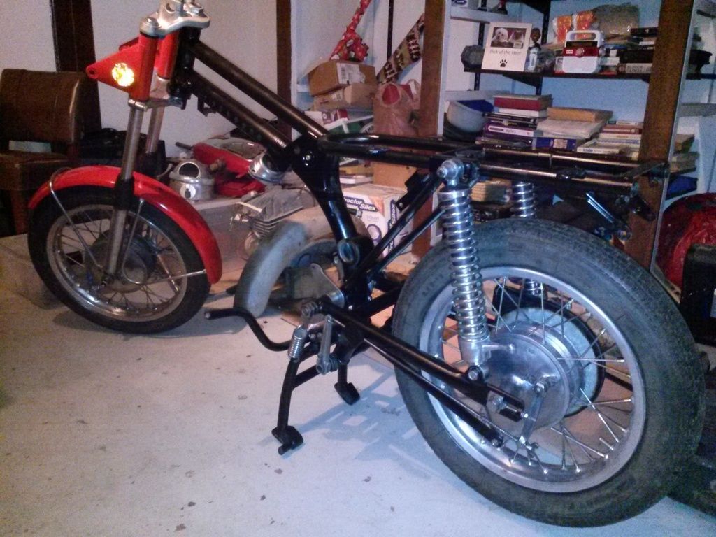

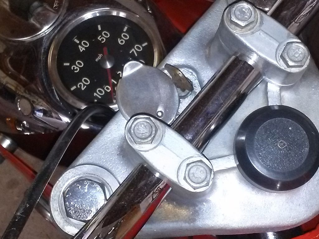

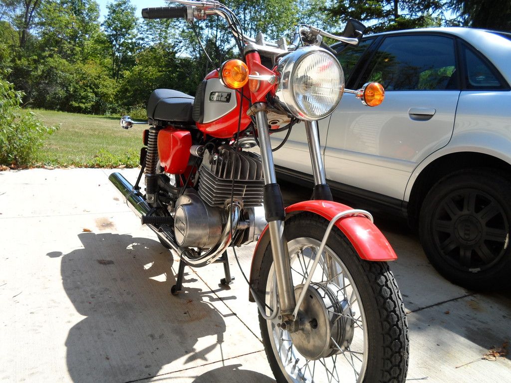

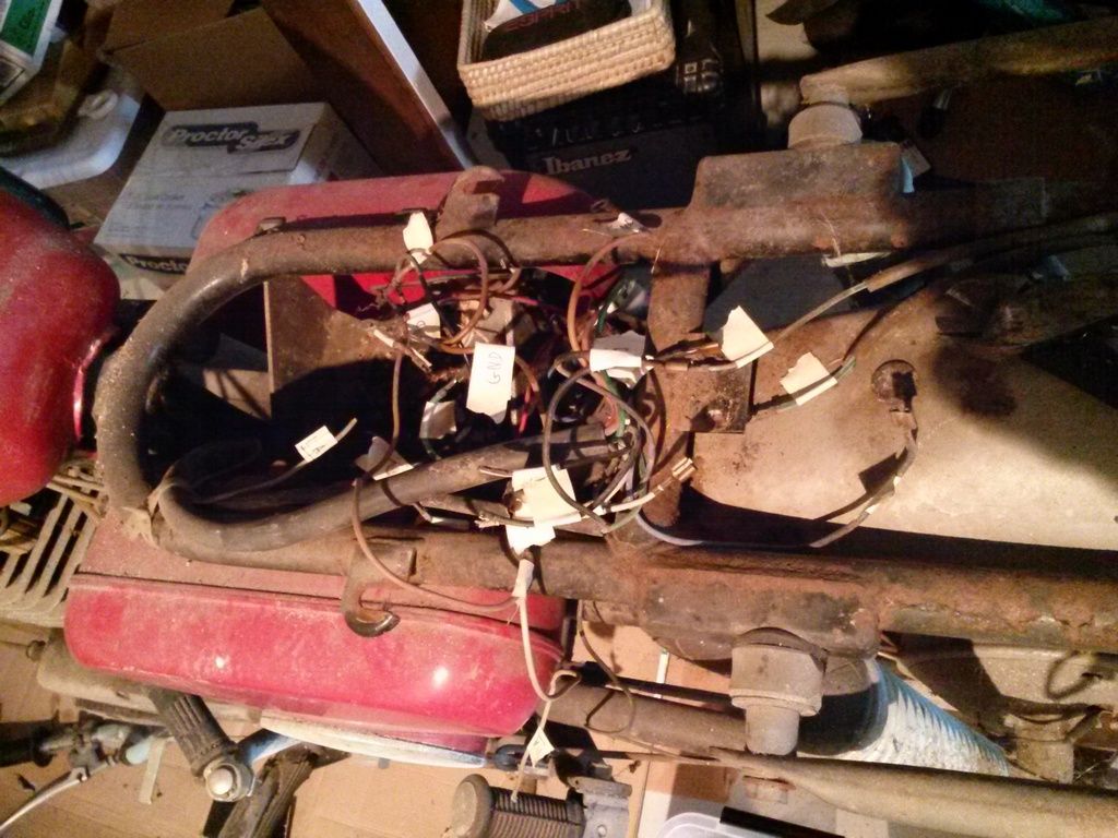

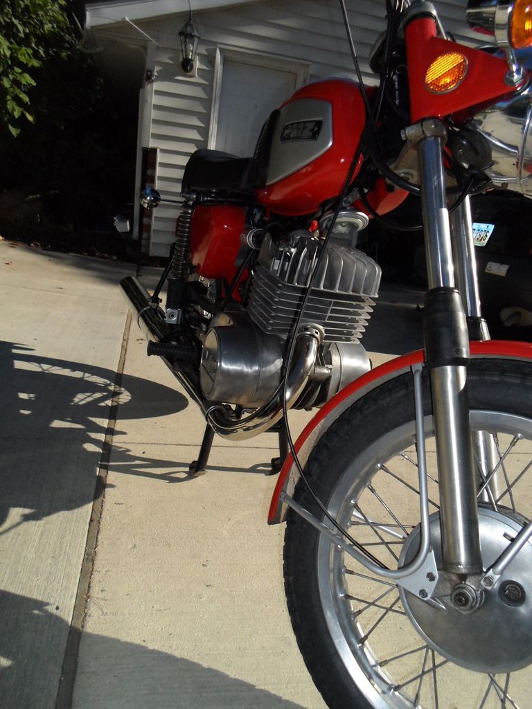

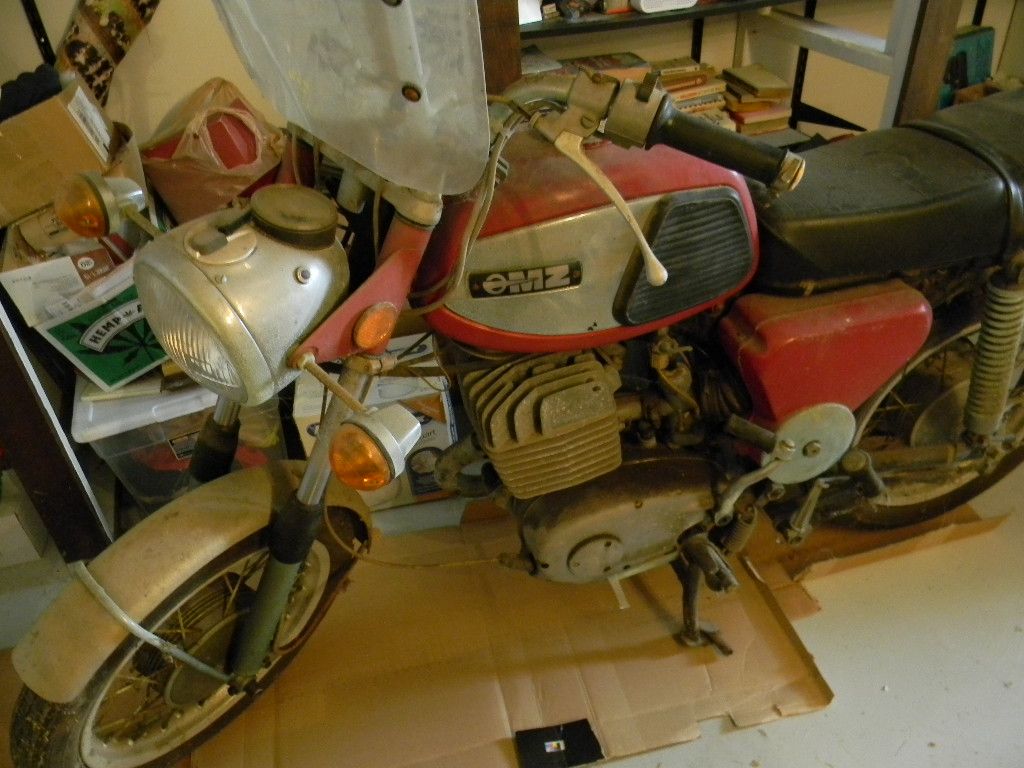

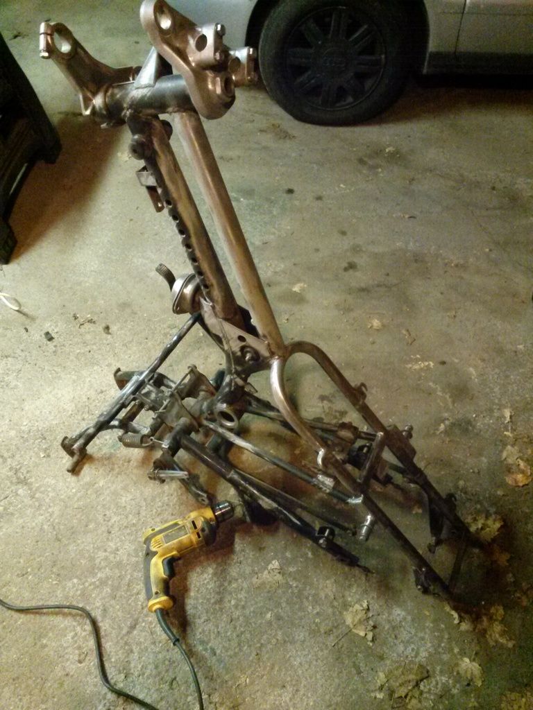

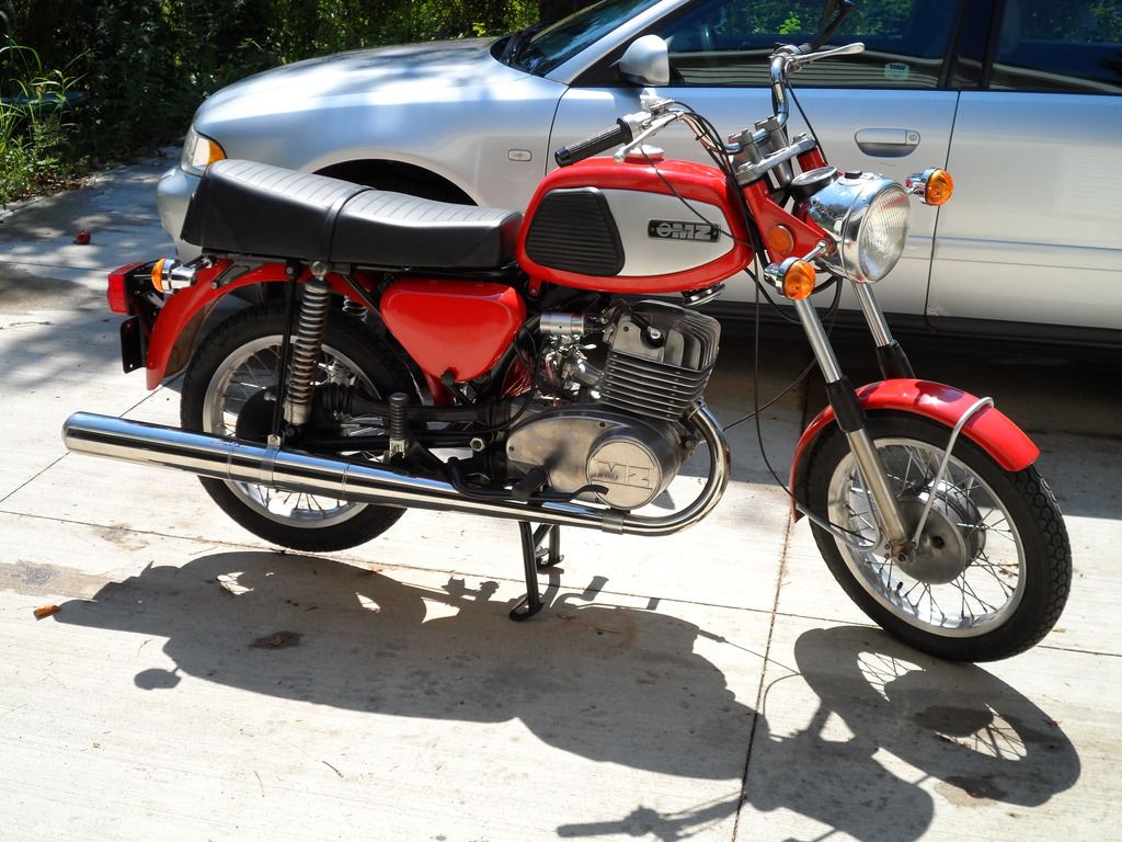

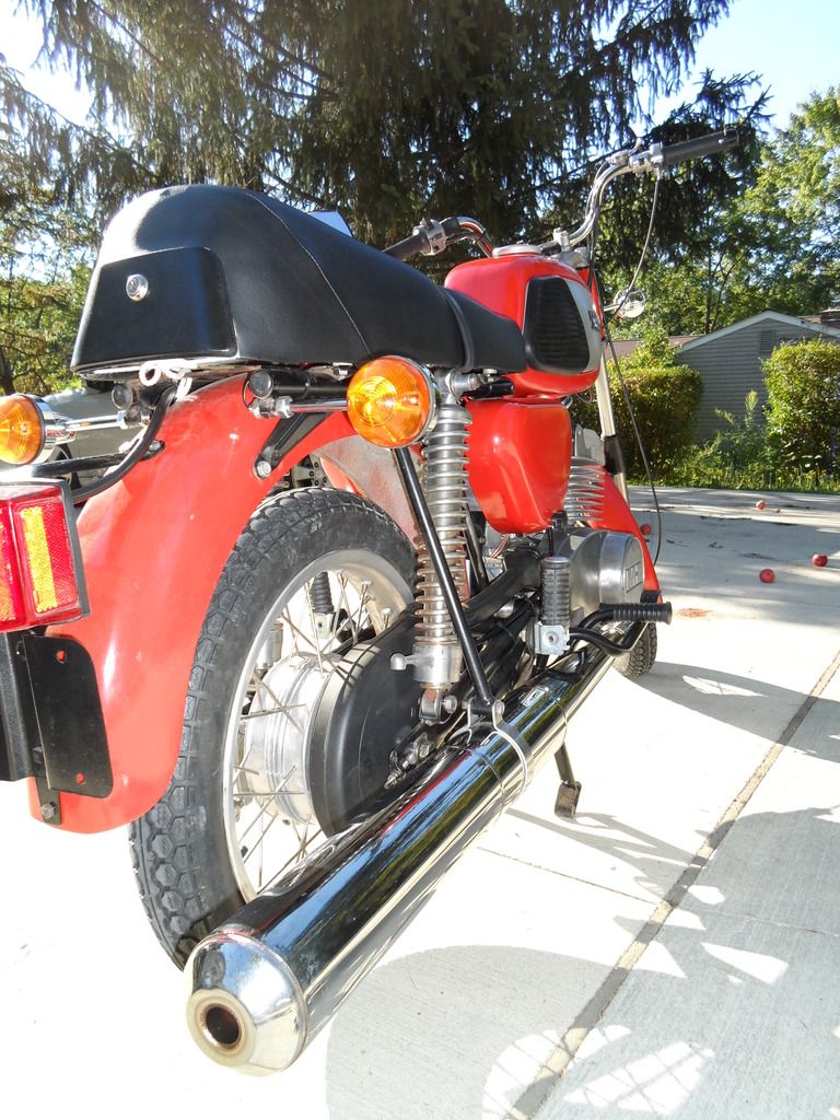

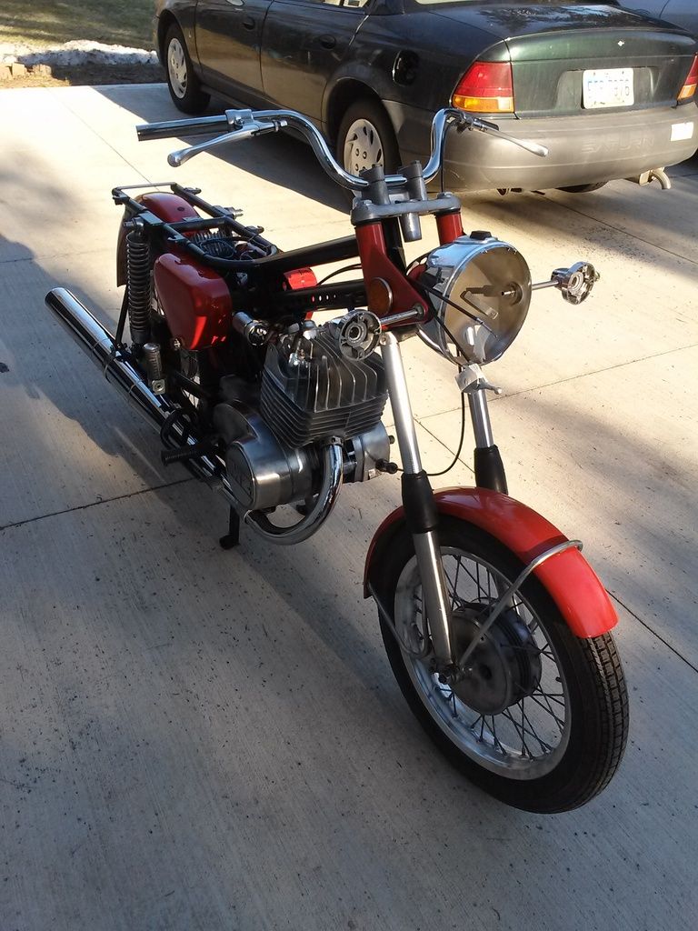

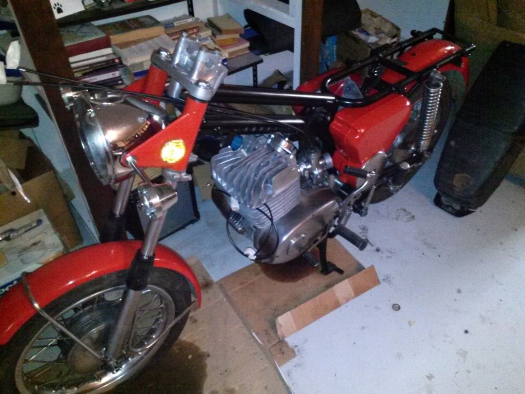

Good morning, folks! Just thought I'd share some pics of my recent restoration of my late Grandfather's 1974 MZ TS250. It was the first motorcycle I had ever had a ride on (31 years ago) and had been sitting in the tool shed ever since. 3 years ago, when I cleaned out the shed and rolled this dusty, rusty bike to the garage, I swore to myself that I would ride it again someday...It took me 9 months and $3000 in parts and shipping from overseas, but it is now 100% functional and starts on the second kick every time.

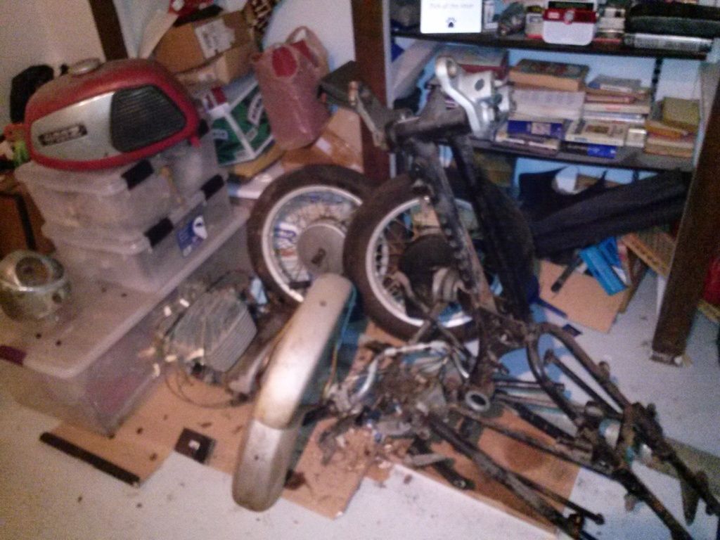

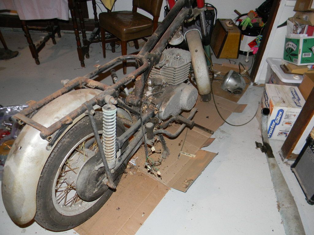

I thought the black bike in the photobucket was the one you restored... after reading the post, then wondering why a guy would rebuild a motorbike in the living room, I would way that for an amature, you appear to have done a great job on making an enjoyable and probably ridable two wheeler!
restoration is a thing not best attempted by amatures...trust me, it takes alot more than a few thousand to redo something to completeness.I(and even after you are finished you realize there are idiots out there who have a complete original that they won't even touch without wearing kit gloves.) great work, what a job. hope it gets you laid.
#13 ·
Thanks! Sadly, it hasn't gotten me laid. I would like to explain that the room is not actually a living room, it is a room that used to be the garage, and I am remodeling it to be a den/bar/lounge. I stopped that work for the winter, and since the floors are still concrete and the real garage is right through the door, what an ideal opportunity to work on it in comfort and convenience. I did do all the stripping and painting in the garage, however. The little black bike is next, and since I STILL haven't finished the floors, it may be a "living room" restoration as well ;)
#14 ·

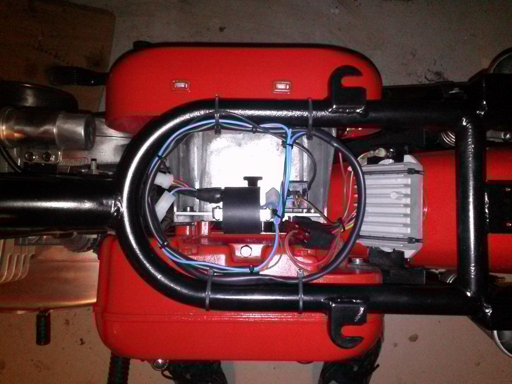

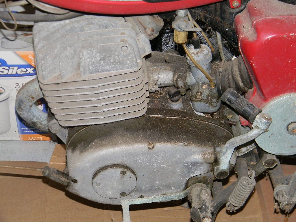

Oh, and she is rideable. Got over 60 miles on her now, and have been over 60 mph, which is about as much as can be expected from such a bike. Unfortunately, a defective tube has her laid up on one wheel, but that should be remedied shortly. Starts on half choke on the second kick every time. One important note in the unlikely chance that somebody else is trying to revive one of these: If it's been sitting for a few years, just ditch the old BVF carb, it's worthless and not really rebuildable, though they do sell kits. I got a Mikuni VM30-83, had to grind just a bit off the inside of the inlet and jet it to 170/47.5, and the air hose was a stretch, but it fit and the stock clamp worked fine. Just be sure that the output side of the carb goes into the intake pipe PAST the pinch bolt slots, or it will diesel and you will be in deep doo-doo. It looks very stock, works great, and only a rare MZ purist will know the difference. Also, I upgraded to a powerdynamo 12v ignition, but hid the aftermarket coil in the battery box and routed the plug cable through the old coil to maintain stock 6v appearance.
