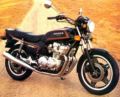

sadly, i have teh DOHC. i will ust be sre not to get them mixed up. idk if i have the k or teh f though, is there any special things to look for. i guess i could just check the model number, its a 80 btw
It will say on the model number if it is a K or an F. Up on the steering neck the model number and VIN should go CB750 then the model designation then the rest of the VIN number. Usually the F's have a kind of spoiler lookin' thing on the back of the seat, a flat seat if yours has the stock one and painted fenders. The K's have chrome fenders and a stepped seat and semi pulled back bars.
http://www.afegraphics.com/80cb750fblack/80cb750f-black-bike-iso-ad-shot2.jpg Picture of an 1980 CB750F
