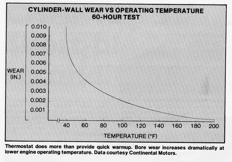

YES!!! :grin: And if you have a rotary, you DO NOT want to run that engine unless you plan on actually driving/riding it. None of this starting it to move it then shutting it down. Rotaries hate cold starts with a cold shutdown.ALWAYS....let ANY engine warm up!
A very high %%%% of total engine wear, over the engines life, occurs at startup.
The second most wear occurs between startup and until the engine reaches operating temperature.
Example: When metal gets cold, it shrinks. So, you have a cold crankshaft and cold connecting rods...the gap between them is much bigger than when the engine is hot...so, while cold, they're pounding against each other..and to add to the disaster, the oil is cold and stiff and doesn't ready flow into the gap...lots of wear occurring.
If you want to absolutely minimize engine wear, then let the bike reach operating temp before riding it.

And I would think that even IF they shrink, it would be well within tolerance.
