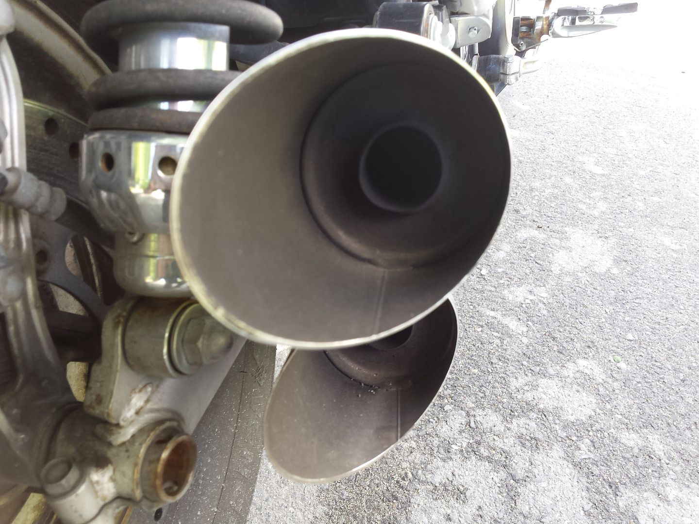

I wish to pull the baffles from my Cobra Slash Cut mufflers, so that I may wrap them. From what I can see, the baffles appear to be held in by a single weld per muffler, as seen in this pic.
Anyone know if they are just welded in on the exit end, or are the baffles welded at both ends? If just one end, I should be able to cut the weld, and weld on a nut after to use a bolt to keep them in, making it easy to remove for when they need to be rewrapped later on down the road.

If you can get a Dremel cutting wheel in there, it looks like it would be easy to cut that weld away and remove the baffle's.

I thought Cobras came with 2,4, or 6 inch baffles, which were interchangeable for customizing your sound.
I'm just guessing, I've never had Cobra, but I'd suspect the muffler comes off the pipe and the baffle comes out the other end.

I had the same problem when I had the Cycle Shack mufflers on my Sportster. They were excessively loud and got annoying. I ended up ordering a set of smart partz baffles. They knocked the edge off the sound to a point I was happy. It may be a less expensive option for you if you cannot remove your baffles. They fit in with your current baffles, and knock the sound level down a half dozen decibels or so. Just right to reduce the annoying peaks in the exhaust note. http://www.smartpartz.com/

Another option might be to get a short generic baffle and fabricate some sort of "cone" holder to mount it to the back of your exhaust outlet.
Unless the packing has completely degraded out of the mufflers you already have wrapping new packing isn't going to change the sound much at all. Plus, they look like they'll be hard to get out of there without damaging the pipe. You can cut the weld, but you'll have to grind it smooth to pull the baffle out over it. I'm sure it can be done, but have plenty of patience.

Are those the Cobra Classics line or the cheaper $200-ish line that don't have heat shields on the head pipes? If it's the latter just ride around for a while and the welds will break away on their own, assuming the frame bracket welds don't break first.
The former.

I had a pair of the latter and they were utter garbage. After having the frame bracket tabs welded back on twice, it torpedo'd a baffle out one day and I had to get that welded back in (once it was cool enough to pick up with my fingerless gloves :D). I don't recall if there was a welding score on the inside or not, it was a decade ago when it happened.
