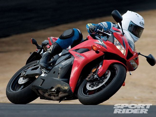

Latest electronic ABS is linked and is best yet.
Try some maximum braking like this:
You've got me wondering what the advantage is to only having one headlight come on with linked braking.;)
So I know that there are some very talented people who can beat ABS in some very controlled racing conditions, I think we have all seen the videos of Rossi pulling some amazing braking coming into a corner where he spends an insane amount of time doing what seems like it must be the most controlled stoppie ever seen, where his back tire spends what seems like forever hovering an inch above the road surface. But that is a super controlled circumstance by one of the most talented riders in the world over known conditions on a properly warmed up bike when he is fully on point competing.
But the difference is I bet a good ABS system could brake at 95%+ of what even Rossi could do on his best track day, but it will do it every single day in every single circumstance, and humans just cant do that. Even the most talented rider in the world isnt going to beat ABS the day they come around a blind corner and are surprised by a deer on a misty morning 20 minutes after they wake up.
Absolutely true. The only time I think I could beat ABS is in a straight line, whether on a bike or a car. I think ABS on motorcycles is one of the greatest advances made for them in the last number of decades.
The greatest advance made for a motorcyclist ever is a well trained and skilled pilot. It works on all bikes, it works good days and bad, it only needs to be current.
