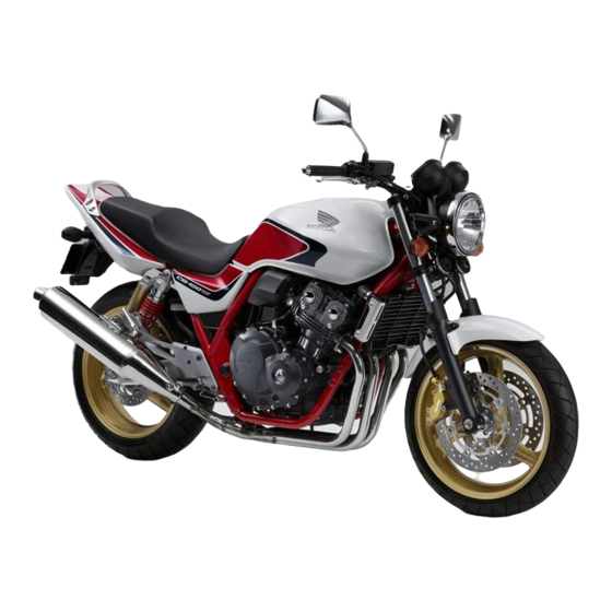

Hi Guys
My 400 SF will nor start unless left for a few hours after the side stand has been used some about the I C U ? it starts first time when the centre stand is used would any body what is wrong and how to fix it
